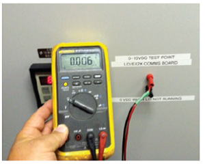

Challenge. Washington County Power is located in a remote area with heavy lightning storms which have shorted out LCI communications boards twice in the past two years, preventing the plant from starting on time.
The facility is a simple-cycle peaking plant consisting of four GE 7FA gas turbines sharing two LCIs through cross-connects for starting. The two LCIs communicate through auxiliary I/O boards in each LCI via a shielded cable. This communication link enables the plant to start any unit from either of the LCIs if necessary. If one auxiliary I/O board fails, it negatively affects the board in the second LCI, preventing the starting of any turbines and causing a forced outage.
The auxiliary I/O board is located under a PLC rack on the inside back wall of the LCI electrical cabinet, an area that’s difficult to access. The only way to check the board is to climb down into the LCI cabinet with a volt meter and a flashlight.
Solution. Plant personnel looked at options to identify the best ways to check the auxiliary I/O boards. After meeting with production manager the decision was made to install test ports into the door of the LCI cabinet. These test ports were wired into the LCI communications board to enable technicians to check board quickly and safely from outside the cabinet (photo).
Results. Adding test ports to the door of the LCI cabinet enables plant technicians to check voltage quickly and safely to determine the status of auxiliary I/O boards after storms. This easy check has been added to the prestart checklist and has proved to be an effective solution.
