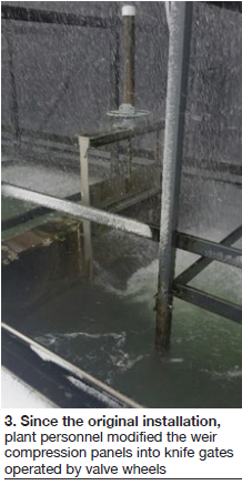

Results. Since the original installation, we’ve modified the weir compression panels into knife gates operated by valve wheels (Fig 3). These allow the gates to be fully compressed into their channels, further reducing any leakage between the two halves of the basin. We recouped the original cost of building the wall—$15,000—the following year, because we no longer had to rent Baker tanks for storage. Overall, this upgrade has greatly improved our annual planning, staging, and cleaning of the facility’s cooling systems.
