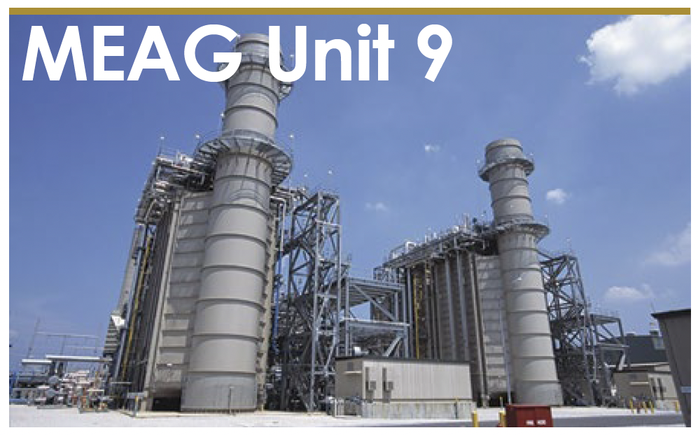

Plant Wansley, MEAG Unit 9, Owned by MEAG Power, Operated by NAES Corp
570-MW, gas-fired, 7FA-powered 2 × 1 combined cycle located in Franklin, Ga

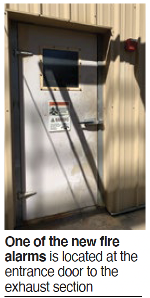

Solution. Staff decided an additional measure of protection was required since there were areas where CO2 could be present, but no visual or audible alarms were available.
Result. To correct this shortcoming, MEAG Unit 9 installed additional three-horn-and-strobe-light combination alarms at the following locations:
Near the bearing-compartment vent.
At the entrance door to the exhaust section (photo).
Inside the exhaust-section enclosure.
This now provides personnel working inside the enclosure immediate and effective notification of the danger in the unlikely event a fire were to occur in the compartment.
