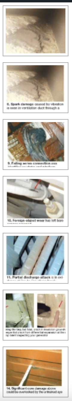

Stator winding
The slot portion of the stator winding is critical, but the areas of greatest interest are behind the wedges and iron core—and inaccessible. Direct view of the bar surfaces is limited and the effects of PD and/or vibration sparking are not possible to determine on many windings. Removal of selected wedges may allow access to important conditions (Fig 7).
On generators with radial core ventilation ducts, borescopes can give good access to the sides of the bars at the ducts. But the distortion inherent in borescope viewing may make difficult the interpretation of what’s being seen (Fig 8). Once again, the technician’s skill and experience are critical to inspection success.
It’s important to manage your expectations: Inspection of the slot portion of a winding often leaves one with an uncertain feeling as to the quality of the winding.
Stator end windings are much more accessible than the slots, and failing connections can be observed (Fig 9). Dust or grease deposits may indicate vibration or foreign objects, but the extent of damage, if any, may be difficult to assess (Fig 10).
PD activity can cause several conditions that are detectable by inspection (Fig 11). The numerous indications on the endwindings may add to the uncertain feelings resulting from inspection of the slot portion of the winding.
Mechanical damage. Where a generator has been subjected to short-circuit or mis-synchronizing incidents, the winding will have experienced high mechanical forces. The tiny cracks that may be seen in an endwinding after such an incident are easy to overlook (Fig 12). Observed cracks may simply have resulted from normal differential expansions within the endwinding (Fig 13). Visual inspection alone might not be sufficient to assess the extent of winding damage.
Stator core and frame
General deficiencies. Most core deficiencies can be observed from the core’s inner surfaces, but the defects sometimes can be so small as to be virtually invisible to all but the skilled inspector conducting a close examination.
If heavy contamination is found on the core ID and in ventilation ducts, inspectors should determine the source and nature of the contamination to facilitate corrective action. Careful inspection, combined—where appropriate—with core flux tests should give a good assessment of core condition.
Core mechanical damage, looseness. Mechanical damage covers a broad spectrum. Minor faults typically appear as small, local areas of solid-metal surface or of scorched lamination paint (Fig 14). They are easily overlooked if inspection is not thorough.
By contrast, severe mechanical damage is easy to spot. It may be caused by core looseness, foreign objects, improper wedging, or careless field assembly and removal. Looseness usually occurs at the inside diameter near the ends of the core, where it is easy to identify (Fig 15). Look for dust generation, punching and spacer movement, or small pieces of punchings that have cracked off.
But while you have good access to core surfaces, keep in mind that there may be issues deep inside the core. This means it’s not possible, ordinarily, to accurately assess core condition by visual inspection alone.
