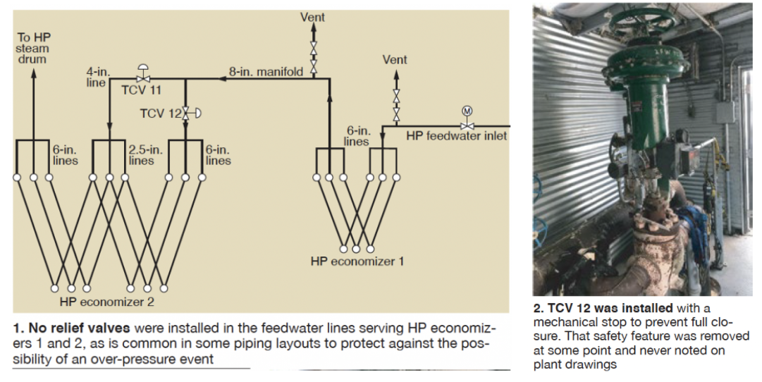

A maintenance technician working in a control/breaker cabinet accidentally tripped two breakers. He responded immediately, returning them to the “on” position. However, re- energization caused the flow-proportioning/temperature control valve TCV 12 (Figs 1 and 2) to fully close.
With turbine exhaust gas still flowing through the HRSG, water trapped in Economizer 2 by the closed valve flashed to steam. Pressure increased to the 5000 psig or so engineers believed it took to burst the joint between one of the 6-in. riser pipes and the SA 106B 8-in. manifold shown in Figs 3 and 4. The good news: No one was hurt.
This accident happened because there was no way to safely relieve a pressure excursion in the feedwater system between the HP feedwater inlet to the two-stage economizer and the steam drum. This was not a design oversight. Rather, a mechanical stop installed in TCV 12 to prevent it from full closure had been removed, unbeknownst to anyone on the current staff.

There are alternatives to the mechanical stop to protect against the inadvertent full closure of control valves in this type of service: Relief valves could be installed in the feedwater lines to the economizer (ahead of HP economizers 1 and 2 in this case) or an unrestricted bypass could be routed around the control valves. All of these methods are acceptable to the ASME Boiler and Pressure Vessel Code.

An unvalved, ¾-in. bypass line was routed around TCV 12 to protect the system going forward. TCV 11 had an intact mechanical stop and did not require a bypass.

- Check your economizers for valves that can block feedwater flow to the steam drum.
- Review original P&IDs and compare them to the system as it exists today. If valve changes have been made over the years that could bottle-up the economizer, correct any deficiencies in timely fashion.
- If your system does not have a relief valve between the boiler-feed pump and the last valve before the steam drum, investigate why there is none. If there is a relief valve, is it being tested and serviced at the proper intervals?
