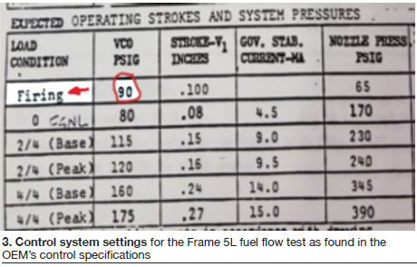

GE control specifications provide valuable information for testing at firing speed. For a Frame 5L operating at 1000 rpm, expected fuel flow from the flow divider to the 10 combustors is 2.2 gpm. This means each combustor should receive 0.22 gal (approximately one quart) for a 60-sec firing attempt.

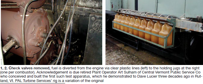

First steps: Remove all 10 check valves from the engine and divert fuel flow (Fig 1) to the test rig (Fig 2). By re-routing fuel via the clear plastic lines, the “false firing” attempt will collect all the fuel. Without check valves, fuel pressure is negligible.

1. Start the gas turbine with selector switch 43 in CRANK and run up to 1000 rpm.
2. Confirm firing time is set for one minute on timer 2F.
3. Move the switch to the FIRE position, and time for 60 sec using a stopwatch.
4. Fuel is diverted to the 10 jugs shown for the “false firing” period (Fig 3). The fuel flow expected is 10 × 0.22 = 2.2 gpm. Thus, each container should collect approximately one quart of fuel. Final step is to empty the fuel lines into each jug. Note that the expected maximum rated fuel flow with the engine operating at 5100 rpm is 37 gpm.

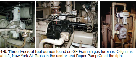

Figs 4-6 show the three types of fuel pumps (Oilgear left, New York Air Brake center, and Roper Pump Co right) GE used on its Frame 5 gas turbines during the US production period from 1965 to 1990.
The test described works equally well for all GE Frame 5s manufactured during this 25-year period. In all cases, fuel flow at “firing speed,” which depends on the engine model, will be less than 3.5 gpm.
