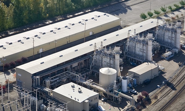

Encogen Generating StationPuget Sound Energy 167-MW, dual-fuel, 3 x 1 combined-cycle located in Bellingham, Wash Plant manager: Thor Angle |
The challenge at Puget Sound Energy Inc’s Encogen Generating Station was typical of what others in the industry are asking today: How do you take a base-load combined cycle powered by legacy frame engines and make it economically and operationally relevant in today’s energy market? In this case, the plant was a 3 x 1 combined-cycle cogeneration facility with Frame 6 gas turbines that went commercial in July 1993.
It supplied up to 130,000 lb/hr of steam and 3600 gpm of hot water to a paper mill across the fence and sold “surplus” electricity (up to 137 MW) to the local utility under a power purchase agreement (PPA) mandated by Purpa (Public Utility Regulatory Policies Act). The host utility purchased the plant in 1997.
During the PPA period, annual plant capacity factor was 95% and above. Plant design and operating procedures dictated a minimum unit run time of 24 hours after a start. The mill closed in July 2008 and the export of thermal energy ceased. Since then, the plant has been dispatched based on natural-gas and electric-power prices. Traditionally, the utility has had a winter-peaking profile, although economic dispatch opportunities are relatively common in July, August, and September.
