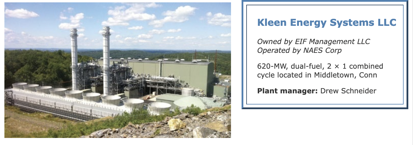

Challenge. Kleen Energy’s 620-MW, 2 × 1 combined cycle is equipped with a multi-cell battery bank that supplies DC power to the gas-turbine electrical package. Each bank of 60 flooded-cell lead-acid batteries has a lower and upper rack with the batteries arranged in two staggered rows (one behind the other).
