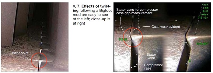

Rocking solution conducive to stator blade twisting. TIL 1769 (Dec 1, 2010) instructs 7F owner/operators on how to inspect their gas-turbine compressors for stator-vane rocking in stages S14 through S16. Much has been published in the CCJ on the subject of vane rock attributed to worn hookfits, with many affected users opting for pinning of the individual square-based vanes into segments to promote rigidity and prevent the release of vanes into the air stream. This solution, developed by Rodger Anderson of DRS-Power Technology Inc, has proved effective over the years.
One of the OEM’s solutions for dealing with vane rock is its so-called Bigfoot mod which involves onsite machining of the casing to create a new hook fit for the vanes. Inspections by Advanced Turbine Support of stages S14-S16 following implementation of the Bigfoot mod indicates twisting of stator vanes in some cases. Such twisting is conducive to casing wear and tear because the Type-409 stainless steel compressor vanes are harder than the cast steel casing (Figs 6 and 7). Hoogsteden suggested that users experiencing twisting might want to trend the casing wear over time.
The editors asked a compressor expert what impact twisting might have on performance. A back of the envelope calculation assuming a nominal 2.5-deg twist could cost from 0.5 to 1% in compressor efficiency.

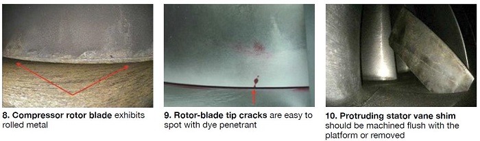

Wait, there’s more. Hoogsteden presented thumbnails and offered experienced commentary on several more TILs during his presentation. Here are excerpts from the editors’ notes:
• 1509R3 addresses R0, R1, and S0. It recommends annual visual inspection for R0 root cracking, R0/R1 tip discoloration, rolled metal (Fig 8), and/or tip loss. The TIL provides detailed recommendations if any of those deterioration mechanisms are identified. Example: For S0 stator vanes, inspection personnel are urged to look for trailing-edge cracks; if found, immediate replacement is recommended.
Advanced Turbine Support is not in complete agreement with the OEM’s recommendations. It believes that annual visual inspections are not sufficiently comprehensive and have the potential to miss small or tight indications that could result in blade liberations and a catastrophic failure. The company’s inspection experts have identified multiple rotor-blade tip cracks (Fig 9) with visible dye penetrant that were not seen during unaided visual inspections.
• 1562 suggests monitoring the condition of compressor shims and the corrective actions necessary to mitigate the risks of migrating shims on both E- and F-class machines (Fig 10). There are 20 possible shim locations in the first five stages (R0 through R4) of 7F units and they are spaced approximately 60 deg apart from each other.
• 1638 addresses, among other issues, F-class R1 case-off ultrasonic inspections for dovetail distress below the blade platform. The testing interval is 8000 fired hours or 150 fired starts, whichever occurs first. This recommendation is modified for peaking units performing more than 150 annual starts to just before and following the peak season. Inspectors have found four such cracks to date.
Advanced Turbine Support recommends users heed caution and opt for in-situ inspections at more frequent intervals. In the case of the last in-situ discovery, Hoogsteden believes there was a high probability of major damage before the next OEM-recommended inspection interval, potentially leaving LTSA customers at risk.

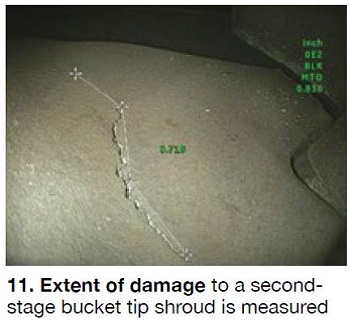

• 1858, 1859, and 1863 concern the inspection of second-stage buckets on the 7FA.03 (7241+e, enhanced compressor). The first advises users to perform the inspections recommended in the document for second-stage buckets of original and modified design to mitigate the risks associated with tip-shroud creep (Fig 11). The second alerts users of the potential need for increased borescope inspections when installing second-stage buckets of original or modified design. The third TIL alerts users of the potential need for increased borescope inspections if the unit operating profile is changed.

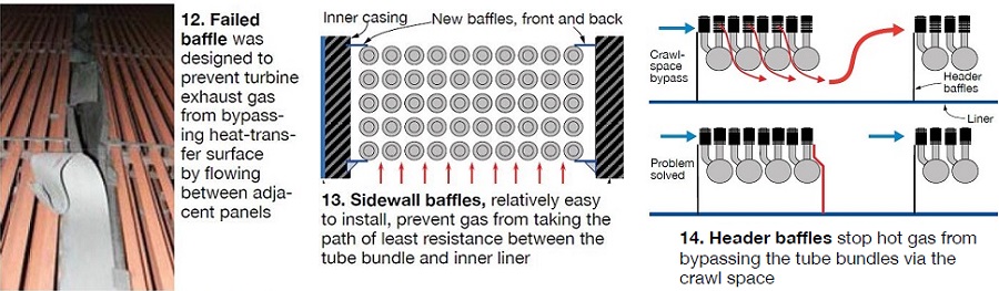

Baffles force turbine exhaust gas through the tube bundles, maximizing heat transfer and performance. Even gaps of only 2 in. between adjacent tube panels, between tube panels and the inner liner, and between headers in the crawl-space area, can cause significant losses, Stanley told the group. Baffle integrity in evaporator and economizer sections is particularly important, he said.
Damaged or missing baffling is easy to identify during a gas-side inspection (Fig 12) and relatively easy and inexpensive to correct with standard carbon-steel components and conventional welding techniques (Figs 13, 14). Perhaps the most costly component of baffle repair and/or replacement is the installation of scaffolding. Therefore, it makes good sense to do this work when cleaning tube panels, which also requires scaffolding.
Stanley noted that thermal performance loss is not the only adverse impact of ineffective baffling; it has been known to contribute to flow-accelerated corrosion (FAC) as well. Also, when baffles in the firing-duct area are not in good condition, duct-burner flames can be disrupted and tubes and the SCR can suffer thermal damage—all in addition to performance loss.
Though baffle work is relatively simple to do, if your unit has excessive gaps in many locations, the plant maintenance budget might not be able to swallow the whole refurbishment project in one gulp. Stanley discussed one such case where performance modeling provided justification and prioritization of the work.
Some gap locations create more performance decrease than others, he said. In the real-world example described, Stanley said that the annual benefit of coil-to-coil baffle fixes in all six access lanes of an F-class HRSG was about $1 million. However, baffle restoration in only two of the lanes produced 60% of that benefit making the investment decision an easy one. In this case, the plant reported a 2 MW increase in output after repairs were made.
