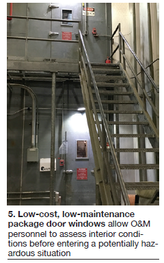

Safety windows help protect personnel
Challenge. The site is equipped with three Siemens 501G gas turbines, each of which is contained within its own packaged enclosure. Without opening the enclosure door, plant personnel had no way to view the interior. This presented a variety of hazards to staff entering the package to investigate alarms or abnormal conditions.
With no view of conditions inside, they could potentially walk into a hazardous situation unprepared. In the event of a fire, for example, the fire-suppression system would extinguish the fire with FM200, but staff couldn’t determine if it was fully extinguished without opening the enclosure door.
Solution. Personnel researched possible solutions—such as installing cameras within each enclosure that showed conditions in and around the entry way. However, the reliability of such systems in a high vibration environment remained in doubt. Plus there were installation and maintenance costs to consider.
The retrofit decision chosen was package-door windows, which presented a more reliable, lower-cost solution. We sourced the windows through the turbine OEM and had them installed by local contractors (Fig 5).
Results. With the door windows installed on all three units, operators now have an unobstructed view of the package enclosure and can. O&M personnel can now easily view conditions inside the package and evaluate a situation before entering a potentially hazardous environment. The windows require zero maintenance other than occasional cleaning and will help streamline the workflow during future outages.
Joel Shanks, O&M technician
Roger Masse, O&M technician
