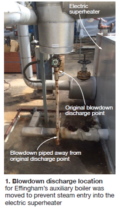

Auxiliary-boiler blowdown relocation
Challenge. The auxiliary boiler’s superheater had been a continuous problem. It is an electric superheater containing several 480-V heating elements. Over time, a significant reduction in current to the unit was occurring, and damage to the heater element terminals also was apparent.
Initially it was thought that this damage was caused by steam leaks through the gasket of the heater-element head. However, while inspecting the superheater, personnel found most of the damage was occurring at the lower right-hand section.
Monitoring of the next startup revealed that when the aux boiler was being blown down, the steam was being discharged directly into the electric superheater.
Solution. The steam was going directly into the air vents of the casing, filling the entire electrical enclosure. These vents could not be obstructed to prevent steam entry because this would not allow the hot air in the superheater to escape.
To protect the electric superheater from the steam, O&M personnel decided to redirect the blowdown line. The discharge of the blowdown line is now well clear of the electric superheater and steam entry into the enclosure is no longer an issue (Fig 1).
Results. Since redirecting the blowdown path of the auxiliary boiler, the condition of the electric superheater has greatly improved. The total amount of amperage has increased, meaning it is operating more efficiently and at higher capacity. In the past, the amperage would trail off over time, markedly. Now the current is stable for a much longer amount of time eliminating the need to shut down for repairs.

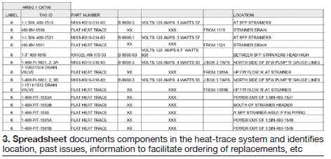

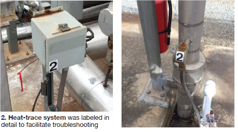

Freeze protection system enhancements
Challenge. The January 2014 record-breaking cold spell shut down the plant because the freeze protection system was not working properly. Process lines and transmitters were freezing. Several transmitters had to be replaced. Insulation, lights, and temporary heat trace were installed to make it through the cold spell.
Some of the damaged instrumentation was not found until months later because of erratic operation. The drawings that were furnished for heat tracing were not thorough or accurate. Example: The heat-trace junction boxes were not marked with circuit numbers making it difficult to trace down the correct circuits.
Every issue had to be investigated and walked down to verify circuitry, making it very difficult and time-consuming to troubleshoot. The plant has seven electrical heat-trace panels with over 60 different circuits. Some circuits have as many as 13 runs that branch out to heat trace, heaters, and/or indicating lights.
Solution. The complete heat-trace system was walked down, verified, repaired, and labeled (Fig 2). A spreadsheet was created to document the mapping of the heat-trace system and any issues that arise (Fig 3). It contains all pertinent information needed if a repair or replacement is necessary. All circuits have been clearly marked and recorded on the spreadsheet, which is kept on the shared drive for all staff to access.
Results. With the heat-trace system labeled and documented, the plant is now able to troubleshoot and repair the circuits without wasting man-hours. Plant instrumentation has better freeze protection, resulting in fewer costs for replacing it. Most importantly, the reliability of the plant is no longer affected by freeze issues.

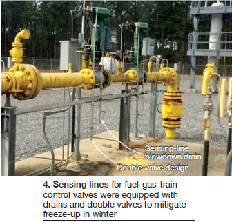

Sensing lines for fuel-gas-train control valves
Challenge. Effingham experienced below-normal temperatures in recent winters causing multiple freezing issues throughout the plant. Among the components affected were the fuel-gas-train monitor and worker control valves. The upstream and downstream sensing lines to these valves accumulated moisture from continuous operation at ambient temperatures below normal.
When moisture blocked the upstream sensing line, the control valve would sense lower inlet pressure and would open more to maintain downstream pressure. This would raise downstream pressure above the design value, causing safety valves on the fuel-gas filter/separators to lift.
Once the water cleared the line, then the valve would sense a higher inlet pressure, causing the valve to close. As long as moisture was present in the sensing lines, the valve would continue to cycle.
If moisture was present in the downstream sensing line, the control valve would see a lower system pressure, causing it to open to increase downstream pressure. Once the moisture cleared the line, the valve would respond by closing, resulting in rapid cycling of the control valves.
This cycling of the control valves resulted in low inlet pressure at the gas turbines. A load runback was initiated to protect the turbine from low pressure in the fuel-gas system.
The relief valves that lifted to protect the fuel-gas system are only designed for one cycle. Typically, the relief valve would not seat properly and result in fuel gas leaking into the environment. Since the plant doesn’t maintain spare relief valves in inventory, Effingham would have to shut down to replace the relief valves.
Both the GT runback and relief-valve maintenance prevented the facility from meeting the day’s scheduled dispatch and the plant would be unavailable until the relief valves could be replaced or rebuilt. This happened on several occasions and each time the plant would have to shut down, if running, and the relief valves rebuilt.
During the winter, the plant lost approximately $42,000 because of sensing-line freeze-up.
Solution. Low-point drains with a double-block configuration were installed in the sensing lines (Fig 4). With them installed, plant personnel can easily drain the accumulated moisture.
The fuel-gas trains are isolated and moisture is drained prior to the onset of low ambient temperatures. Also, during the winter, plant personnel drain moisture from the sensing lines monthly to prevent freezing issues.
It took approximately two days to install the additional drain legs to the sensing lines in early 2010, during plant downtime. There was no cost associated with the installation other than the tubing, valves and labor. The tab was approximately $1,000.
Results. After installing the low-point drains for the fuel-gas-train control valves in 2010, the plant’s freeze protection procedure has plant personnel drain moisture from the sensing line monthly during the winter. The facility has had no further issues with freeze-up of these sensing lines and there has been no loss generation or revenue since installation.
