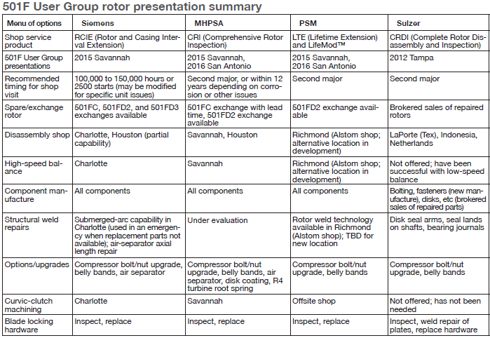

With hours and starts piling up on 501F engines, owner/operators of units about 15 or more years out from COD become concerned about rotor mortality. What to do? Chairman Snyder told the editors the board of directors is encouraging discussion of rotor-shop service options in Reno by the industry heavyweights identified above so users can compare vendor offerings.
To assist owner/operators, one 501F board member compiled the table of rotor service options (below) based on presentations by the major players to these users over the last few years. This is particularly valuable for 2017 conference-goers because they can pencil in changes during the meeting and have an up-to-date reference before returning to their plants.
Of course, attendees will have to add GE information, this being its first 501F meeting. And PSM information might have changed some since last year. The company’s acquisition by Ansaldo Energia was not completed until after the 2016 conference and updates are likely on the location of the rotor disassembly shop, high-speed balance capability, structural weld repairs, etc. The presentations referenced are available to 501F users on the organization’s website at http://501f.users-groups.com/.
