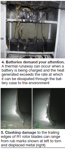

To underscore the need for broad programs like systems knowledge and management of change, he recounted the failure of DC power
supplies (Fig 4) at a plant which affected the AC side of the electrical system and caused a loss of lubrication on coast down, which went on to impact the entire turbine. “Check your batteries!” he urged. This kind of failure apparently occurs at least once a year, with an average equipment loss of $20-million.
He labeled such failures routine events with severe consequences, as contrasted to routine events, including transformer failures and, as another example, clashing damage in Frame 7 compressors (and also in some Frame 5 and 6 units) attributed in part to vane lock-up in carbon-steel vane carriers (Fig 5).

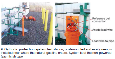

- Our plant doesn’t have adequate cathodic protection because the original plant designers didn’t think it was needed because we are a desert location (Fig 9).
