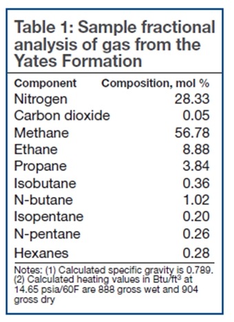

The gas turbines at these sites are unable to burn 100% Yates Formation fuel. High nitrogen will lead to excessive NOx emissions. Plus, the large inert fraction has a negative impact on flammability limits. Low flammability ratio makes it difficult to maintain stable combustion across the operating range. Therefore, blending of Yates gas with pipeline-quality gas is necessary to maintain performance within the prescribed range, and still burn as much of the less expensive off-spec fuel as possible.
The fractional analysis of the off-spec gas (Table 1) shows that it is 28% nitrogen, while pipeline gas is 2% nitrogen. If the gas is blended 50:50, the total nitrogen content would be 15%, the upper limit recommended by the turbine manufacturer for these machines (Table 2).

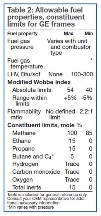

It is common practice in the electric power industry top use the lower heating value (LHV) when calculating the thermal efficiency of gas-turbine cycles. GE and others use the Modified Wobbe Index (MWI) as a measure of the interchangeability of gaseous fuels for a given system design.
MWI=LHV [divided by] (SG x T[gas])[0.5], where T[gas] is the absolute temperature of the fuel gas in degrees Rankine. An alternative and easier-to-apply form of this equation is the following: MWI=LHV [divided by] ((MW[gas] [divided by] 28.96) x T[gas])[0.5], where SG[gas] is the specific gravity of the fuel gas relative to air, MW[gas] is the molecular weight of the fuel gas, and 28.96 is the molecular weight of dry air. For more detail, consult GEI 41040G, “Specification for Fuel Gases for Combustion in Heavy-Duty Gas Turbines,” which is accessible on the World Wide Web.
Because the Wobbe Index indicates the interchangeability of the fuel gases, it can be used to control blending. Both Wobbe Index and heating value make similar curves, so either can be used to control the nitrogen content of the final blend. The traditional method of controlling the blend, flow control for the off-spec fuel and pressure control for the pipeline gas, is simpler but certainly not the optimum.

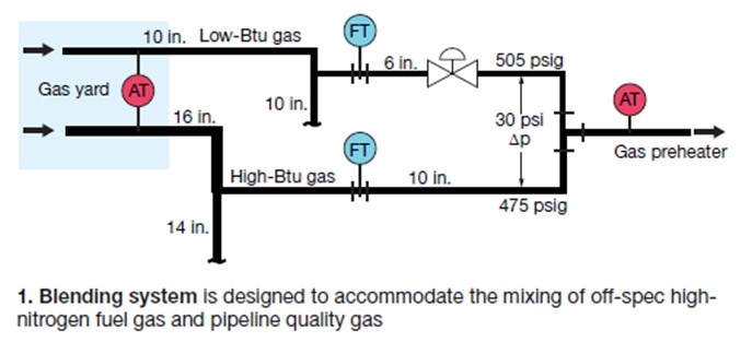

A reliable gas analyzer anchors the blending system design (Fig 1). For this project, COSA Xentaur Instrument Corp’s (Yaphank, NY) COSA 9600™ Wobbe Index meter was selected. It has the following features deemed important in this application:

In addition to the unit analyzers, a dual-stream analyzer at the fuel yard provides a feed forward signal to the individual blending stations. The analyzers at the discharge of the blending stations are used to bias the blending station for the proper blended fuel introduced to each turbine. The analyzers transmit data to the DCS to control the flow of off-spec gas. All blending- station logic resides in the plant DCS.
Actual blending of the fuel sources is accomplished in a “T” downstream of the off-spec gas flow control valve. In order to properly mix the fuel gases, a 30-psi minimum differential is maintained between the two gas supplies at the blending stations.
The DCS sends a pressure set- point signal to a programmable logic controller (PLC) at the fuel yard to control the off-spec gas pressure at the blending station at 30 psi higher than the pressure of the pipeline-quality gas. The arrangement is relatively simple and does not require a valve in the pipeline-gas lines at the blending stations or an elaborate skid arrangement.

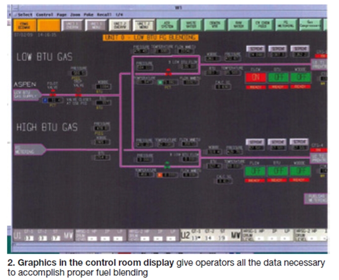

Blending-station logic configuration is programmed into the plant DCS. An Allen Bradley PLC (Rockwell Automation Inc, Milwaukee) in the fuel yard interfaces with the DCS to gather data and control blending. Monitoring and control of the blending stations are done through the control room operator interface (HMI). Operators can select heating value, Wobbe Index, or flow as the basis for control. Graphics give the operator a visual presentation of all data related to fuel blending (Fig 2).

During commissioning, both methods of controlling fuel blending were tested but no differences were identified between the Wobbe Index and heating value. Because the Wobbe Index is incremented in finer divisions, one would expect that finer blending control could be obtained, but for this application, such fine adjustments are not necessary. Off-spec gas on flow control is the default blending control method. This method was also tested, both as an operator-selected operating mode and as a default control mode should one of the analyzers fail.
The plant currently operates in the manual flow-control mode, because the supplier cannot yet provide enough off-spec fuel for continuous blending operations. When the pipeline is packed and the pressure sufficient, the plant puts the blending station in service, typically one day a week. No problems have been reported with the blending station since it went into service. Plant management is pleased with the blending system operation but disappointed with the amount of off-spec fuel available. CCJ
