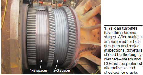

Mike Hoogsteden, Advanced Turbine Support LLC’s director of field services reminded the large gathering of owner/operators at the company’s booth during the 2017 7F Users Group vendor fair, May 15-19 in San Antonio, about the importance of proper F-class turbine wheel inspections.
To increase the probability of detecting flaws of critical size, he recommended thoroughly cleaning dovetails after buckets are removed (Fig 1) for hot-gas-path (HGP) and major inspections. The preferred methods of preparing dovetails for inspection are steam cleaning or CO2 blasting.

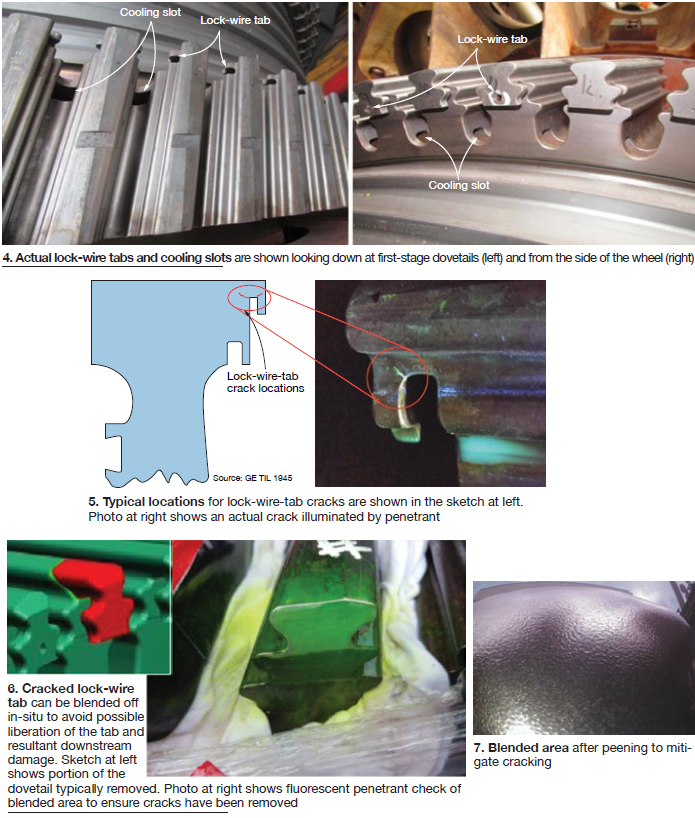

Cooling slots. Hoogsteden went on to say the company’s technicians have identified 16 cracks ranging from 0.04 to more than 2 in. in length propagating from first-stage cooling slots (original configuration) in 7F engines since 2013 (Figs 2 to 4). He added, “In 2017, three units were found to have conditions which condemned wheels and component replacement to enhance unit reliability and safe operation.”
Owner/operators of units with the original cooling-slot configuration can minimize the possibility of cracking, the field service director said, by way of a blend/polish/peen procedure that results in a component radius and compressive stress in accordance with best engineering practice. Fluorescent dye penetrant inspection is used to confirm the absence of indications.
Lock-wire tabs. Cracks propagating from the edges of first- and second-stage turbine-wheel lock-wire tabs are another concern (Fig 5). Typically, cracks in these locations are viewed as less critical than those in the cooling-slot area. Here’s why: An affected tab can be blended off in-situ (Figs 6 and 7). A caveat: If three or more consecutive tabs on a given wheel are cracked, tab removal is not an OEM-approved solution. That turbine disc would require engineering disposition and most likely would be condemned.
