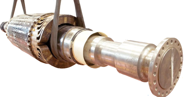

It recommended a time-based maintenance frequency: minor outages every 30 months (with end shields dismantled but field remaining in place) and major outages every 60 months (including removal of the field from the stator), with the first major outage scheduled a year after generator first operation. Note that inspections of old, long asphalt-insulated generators were recommended more frequently.

2002. The revision GEK 103566A (2002) kept the above maintenance frequency but brought one significant change: A major outage can be performed as before by removing the field from the stator or, alternatively, by robotic inspection. The robotic device has video camera capability, and it can also test stator wedge tightness and core shorted laminations (ELCID).

2017. GEK 103566L, dated February 2017, is again a major revision. It declares the intention to remove the generator rotor only when a repair requires necessary access (but mentions that some generator designs may still require rotor removal).
A new table shows examples of events or trends predicting the need to remove the rotor. The historic generator terms minor and major outages are not used anymore and they are respectively replaced by borescopic and robotic inspections.
The difference is a borescopic inspection is typically done via a manhole or by removing a cooler (the end shields do not require removal). These inspections alternate in time; however, after many years or numerous starts, just robotic inspections are recommended.
