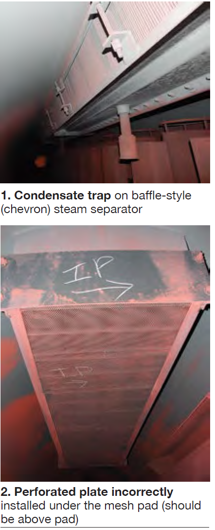

It is important to inspect each drum and pay close attention to the final (secondary) steam separator that covers the steam outlet to the superheater. It limits carryover of water droplets and impurities that can quench or plate out on downstream tube surfaces. Excessive carryover can lead to loss of superheat and elevated risk of tube damage from high temperatures. If enough water carries over, it can quench the tubes, causing fatigue damage at the header joints.
The final steam separator is typically an angled array of baffle plates or it may be a box filled with a mesh pad. For the baffle-plate style, a drain pipe should extend from the housing and either have a condensate trap or extend below the normal water level (Fig 1). This drain evacuates water from the casing while preventing steam from bypassing the baffles.
For separators that appear as a mesh pad in a box, the top and bottom typically have different mesh specifications. If installed upside down, the carryover will be higher than intended.
A more serious condition occurs when a perforated plate is placed on the bottom side of the mesh (Fig 2). The plate should be installed on the top of the mesh to boost the pressure drop through the separator, which evens out the steam flow through the mesh box, and lowers local velocities.
If installed on the bottom it does just the opposite. The orifice holes shoot high-velocity steam and water particles through the mesh, making it less effective and preventing any accumulated water from draining. The result is high carryover of water and impurities into the superheater.

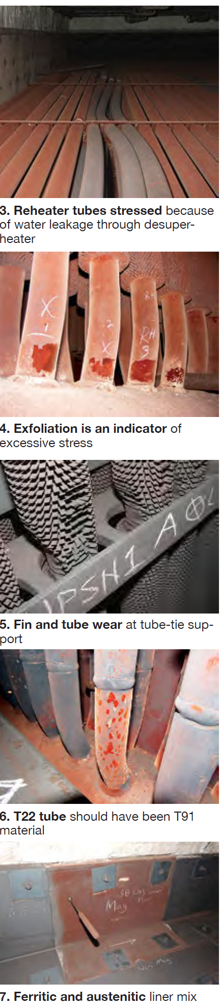

Stressed tubes. Warped tubes are not necessarily a liability, but they are signs that the tube has been stressed and has yielded (Fig 3). Additional fatigue may cause failure. Cracking might be apparent in tube joints. Stress is common in the superheaters, reheaters, and economizers (Fig 4). Failures have been known to occur shortly after commissioning.
External tube wear. Tubes are susceptible to oscillation from forced vibration caused by exhaust flow. A tube-tie support lattice typically is installed at multiple points along the height of the tube bank to limit this oscillation. If the tube ties are spaced too far apart or if they are loose, tube vibration causes fin wear, and eventually wear on the tube wall. Fig 5 was taken during a first post-fire inspection. It is wise to inspect tubes for signs of wear on the upstream and downstream sides of the first tube bank (as a minimum inspection).
Tubes should not be allowed to vibrate more than 0.125 in., assuming there are sufficient tube-tie restraints and that there is no sign of excessive or ongoing fin wear. Severe wear has been observed in early operations. Owners have contemplated removal and modification of tube panels to correct this issue or even purchased new panels if the wear exists on many tubes.
Overheated materials are those that have been subjected to a sufficiently high temperature for a length of time to cause changes in microstructure, or excessive scale formation (Fig 6). The materials are perhaps mismatched to the location in the HRSG.
In some cases, an entire group of components is mismatched, but more often, one or more individual pieces get mixed in with the correct materials. This is common almost exclusively to the inlet duct and firing duct (Fig 7). Inspectors may find one liner sheet, gas baffle, or tube that looks out of place. If not corrected, early failures can be expected.

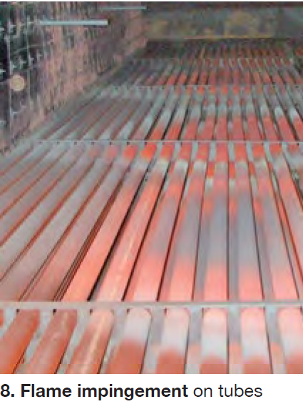

Duct burners. Look for signs of flame impingement on the walls or downstream tubes (Fig 8). Long flames or excessive localized heat can be caused by failed burner nozzles, inadequate fuel distribution, inadequate exhaust distribution, or improper controls.
Failure of one threaded burner nozzle can shoot flames far into the downstream tube bank.There could be hundreds of nozzles, and tube damage only requires one nozzle to fail. (One owner/operator looks for this condition by monitoring stack exhaust for elevated CO emissions.)

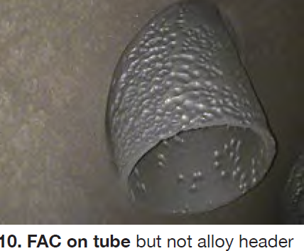

FAC risk assessment. Flow-accelerated corrosion may be the most detrimental and expensive of tube and pipe failures (Fig 10). Localized damage from FAC often occurs in major components or all components of evaporators and economizers. An external release of water and steam from FAC damage can be fatal to personnel. Highly dependent on water chemistry, damage from FAC can develop rapidly with visual wear occurring in less than one year. Some HRSG designs are more susceptible than others, and OEMs typically do not consider the owner’s water-chemistry programs.
The HRSG should be evaluated for risk of FAC before the third year of operation. A follow-on FAC inspection plan can then begin. However, your FAC mitigation program should begin earlier if there are telltale signs on FAC in the LP or IP drum in Year One.
An FAC risk assessment will look at each component of the HRSG and feedwater systems that has potential for either single- or two-phase FAC. Many HRSGs are now constructed using FAC-resistant materials in high-risk areas and in those cases, the scope or frequency of inspection can perhaps be reduced but should never be neglected.

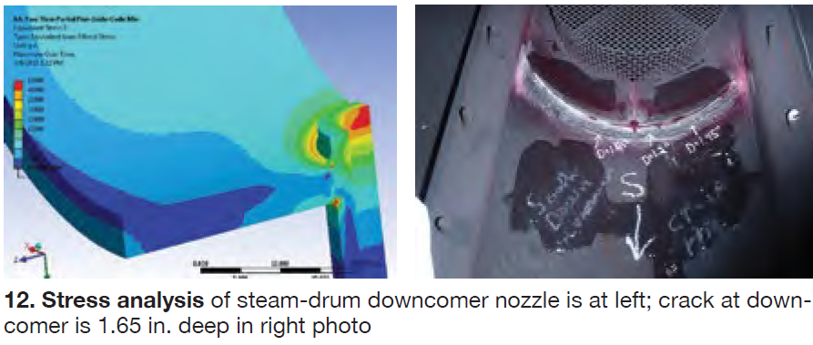

HP-drum pressure ramp rate. HP steam drums in cycling service are susceptible to fatigue cracking of nozzles, particularly the downcomers. Inspections have revealed cracks that extend over half of the lower shell-to-head weld, and up to half the thickness of the weld.  Exceeding the maximum ramp rate will increase the risk of such cracking.
A complete understanding of the basis for the ramp-rate calculation also is needed. If the purchase specifications required a specific ramp rate, it likely was based on a specified number of cycles. A future increase in the number of yearly cycles would yield lower recommended ramp rates. If the number of yearly cycles increases beyond what was specified, cycling analysis along with additional FEA analysis of the drum can produce new ramp curves (Fig 12).
