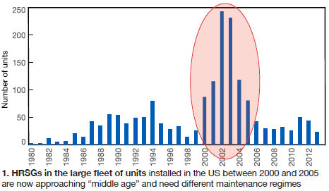

The same thing is true with heat-recovery steam generators (HRSGs). Combined-cycle plants experienced the equivalent of the post WWII “baby boom” between 2000 and 2005 (Fig 1). These units are now in or approaching the second half of their 25-30-year design life.

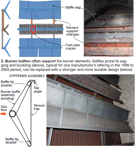

Up next were duct-burner problems, notably baffle sagging, cracking, and fluttering; flame-holder failures; coking; burner-nozzle cracking; and flow-distribution equipment failure. In the case of baffles, for example, they often sag under their own weight as the radiant heat weakens the metal. Because they also provide horizontal and vertical support to the burner elements, weakness in the baffles causes problems in the burners, such as fatigue cracks. Fig 3 illustrates the some of the issues with one type of burner and vintage, and the fix HRST has implemented.

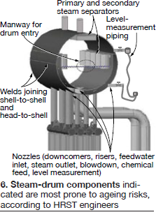

Part deux of the HRST trio of presentations at CCUG was handled by Lester Stanley and focused on HRSG steam drums. Stanley led off with a quick primer on steam drums, their function, and refresher illustrations, and a list of five important steam-drum components (Fig 6). Then he identified the five issues he would address:

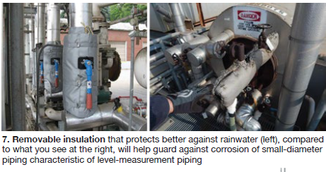

The condition of drum-level piping is critical for accurate level sensing. Age-related risks include plugging of sensing lines with debris and corrosion of small-diameter external piping. The latter risk grows with increased downtime. Removable insulation blankets exacerbate rainwater ingress. Solutions are to inspect under insulation more frequently and consider use of removable insulation with better protection against rainwater (Fig 7).

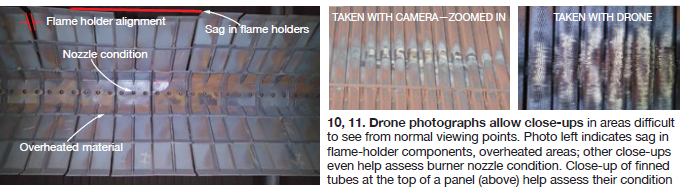

The second part was replete with rather dramatic comparisons of what you “see” with a drone inside your unit versus what you can detect visually looking up from the floor, including photos of burner condition (Fig 10), close ups of burner nozzles, hairline cracks in flame holder castings, bent igniter tubes, close ups of finned tubes at the top of a tube panel (Fig 11), and many others.
Teuchert’s main conclusion is that drones allow you to inexpensively inspect areas prone to ageing issues more frequently, and thus avoid costly problems down the road. CCJ
