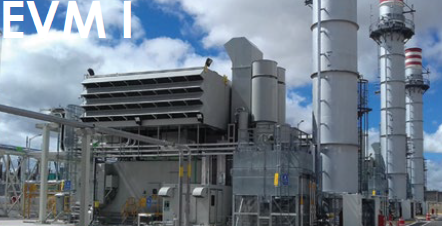

100-MW (net), gas-fired, three simple cycle LM6000PF gas turbines located near Mexico City
Plant manager: Javier Badillo
Challenge. The semi-arid climate in the agricultural area home to the 3 × 0 LM6000-powered Energia del Valle de Mexico (EVM I) powerplant is conducive to a large amount of dust during the dry season. In addition, a new combined-cycle plant (EVM II) is being built 300 meters from EVM I, contributing still more dust as a consequence of earthwork, excavations, and heavy-equipment transit.

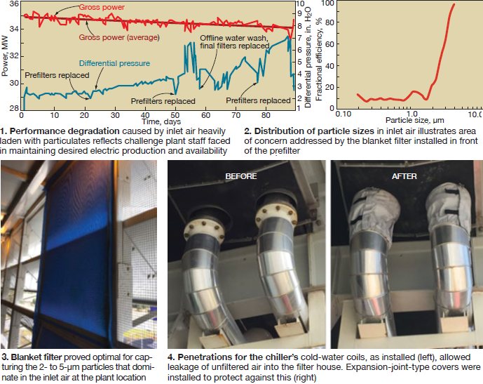

Dust clouds caused the gas-turbine prefilters to load to capacity in about five weeks. The higher pressure drop at the inlet, combined with excessive fouling of the compressor, led to a rapid loss in power production.
EVM had installed a chiller for power augmentation, but the large amount of dust that accumulated in its coils made it almost impossible to operate the system in a continuous and efficient manner.
In less than a year of operation, the plant had replaced its final cartridge-type filters twice and suffered a 4% decrease in output, on average. Fig 1 illustrates the performance degradation over time.

Installation and testing were conducted in May 2018. The 10-PPI filter selected proved optimal for capturing the 2- to 5-µm particles that dominate in the inlet air at this location (Fig 2). In addition to Poret’s favorable filtration characteristics, it is supplied on a roll and easy to install (Fig 3).

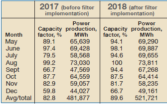

Results. Installation of the filter blankets and pipe-joint covers was done with in-house labor to minimize project cost. The pressure drop of clean (new or washed) foam filters is 0.28 in. H2O; washing is done when the pressure drop reaches 0.50 in. H2O. Note that the very low pressure drop incurred by the blanket filters does not significantly impact the total pressure drop across the entire air filtration system; hence, impact on electric production is minimal.
The blanket filters enable the plant to achieve a nearly constant electrical output throughout the year and a higher capacity factor than was possible before their installation. More specifically, the reconfigured air filtration system (1) increased the interval between compressor offline washes from quarterly to semiannually, while improving plant performance (table); (2) extended the life of the original prefilters from a nominal four months to one year; and (3) enabled an doubling of the replacement interval for fine filters from one year to two.
Plant personnel predict a cost saving of about $800,000 (net present value) in prefilters and fine filters over the next 20 years because of the Poret blankets.
