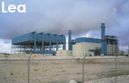

Lea Power Partners LLC
Owned by FREIF North American Power I LLC
604-MW, gas-fired, 2 × 1 combined cycle (501F) located in Hobbs, NM
Plant manager: Roger Schnabel
